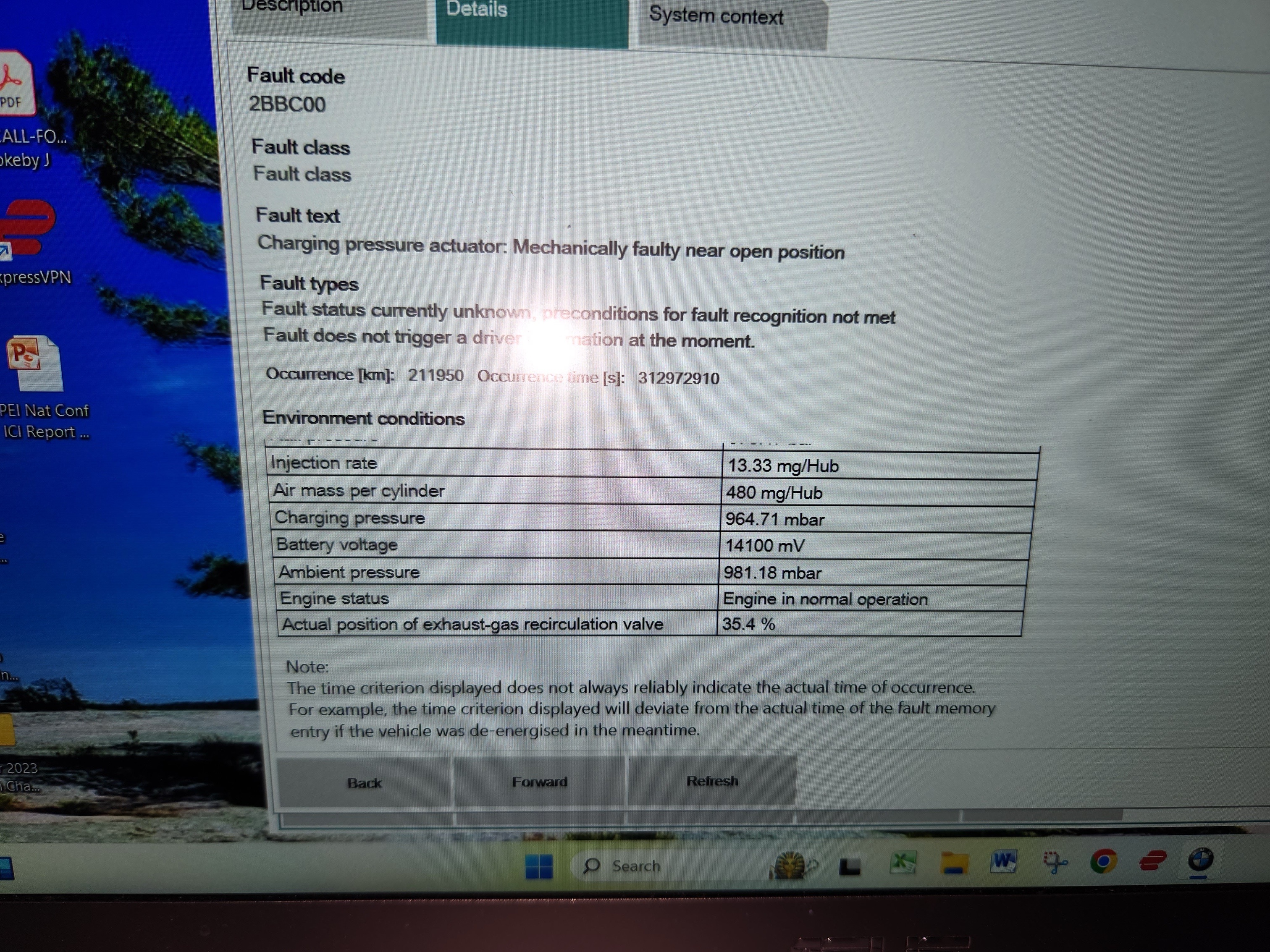

I have not noticed any loss of power or performance (head gasket) and the turbo seems to be good as well although I recently got a code in ISTA (Code 2 BBC00 - Charging pressure actuator: mechanically faulty near open position). This fault was cleared and has not come back over a couple weeks. Interestingly, among the reported conditions at the time of the fault was the ‘Actual position of exhaust gas recirculation valve’ showing 35.4%. Hmmm…thought the tune should have this at 0% but not sure on that.

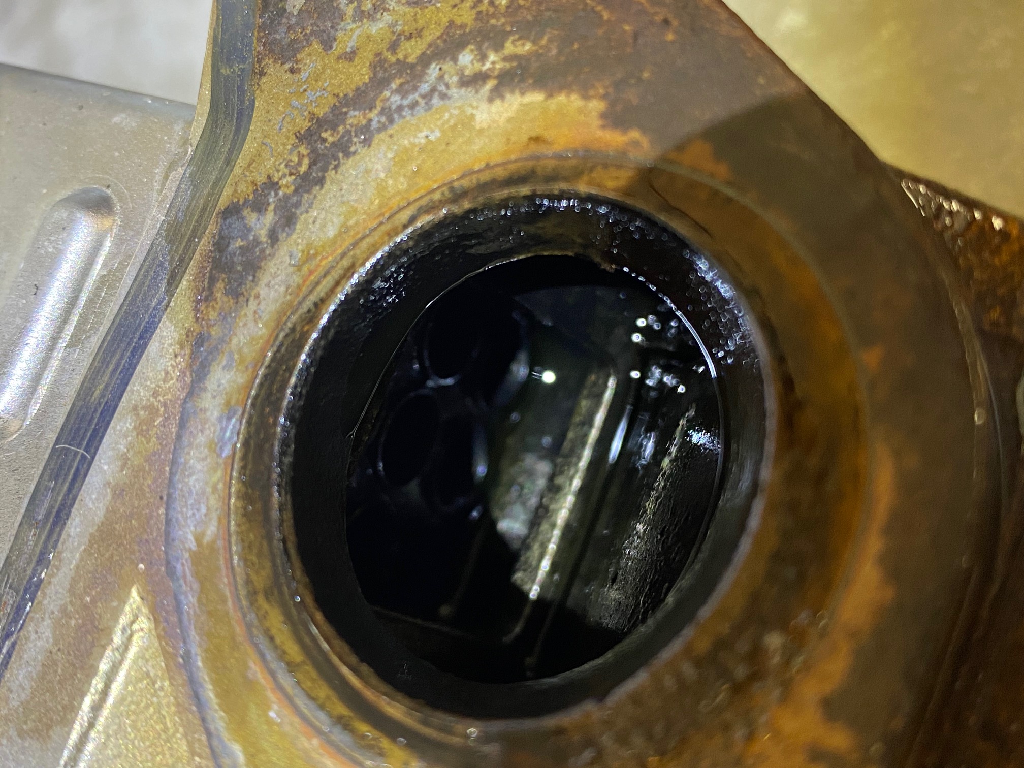

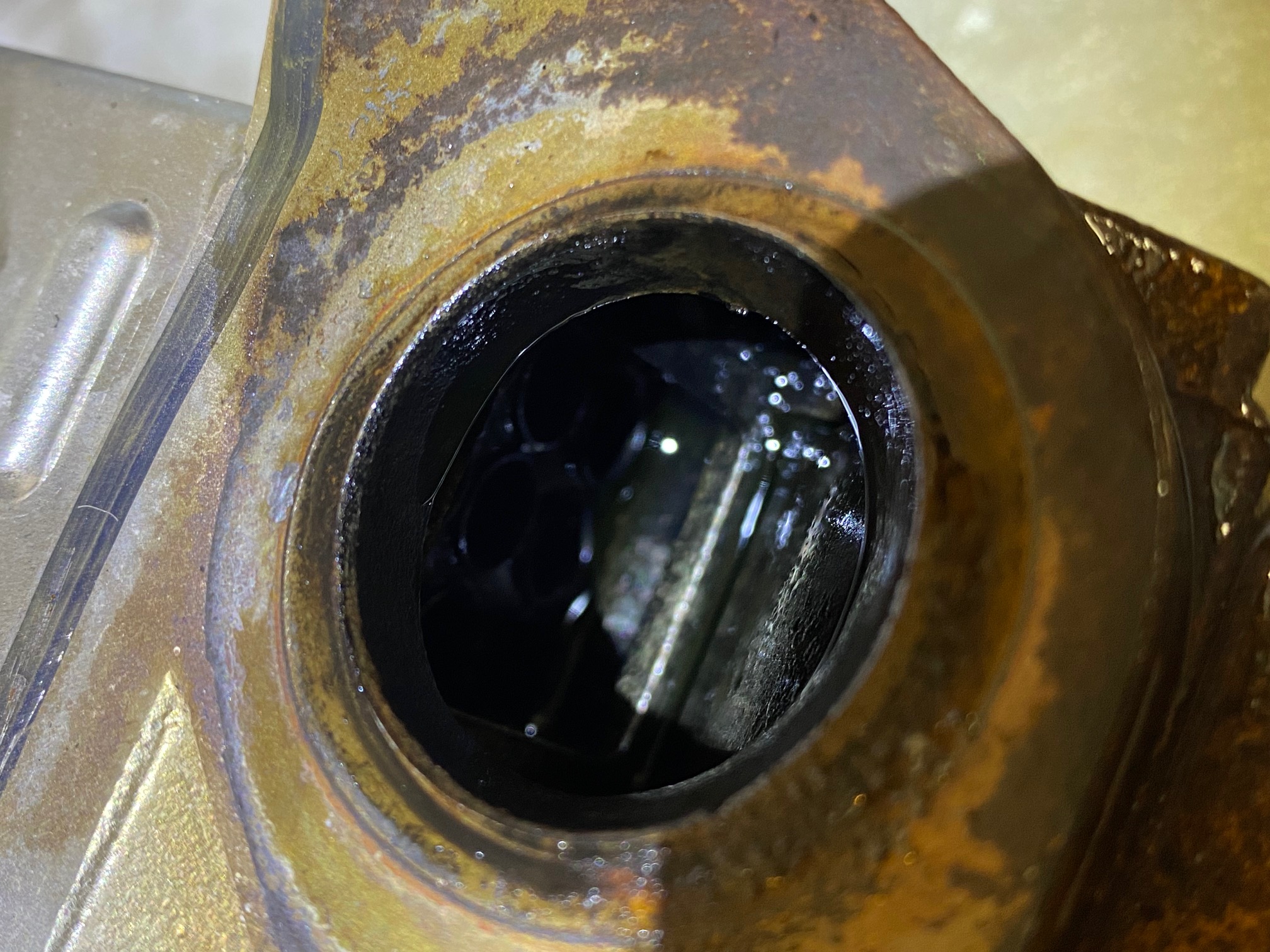

I had coolant leakage on EGR cooler next to exhaust early this year. Unfortunately it also fail like the EGR cooler in front of the engine.
it isnt hard to replace ... can remove and inspect ... visual inspection can confirm the issue.

pictures
