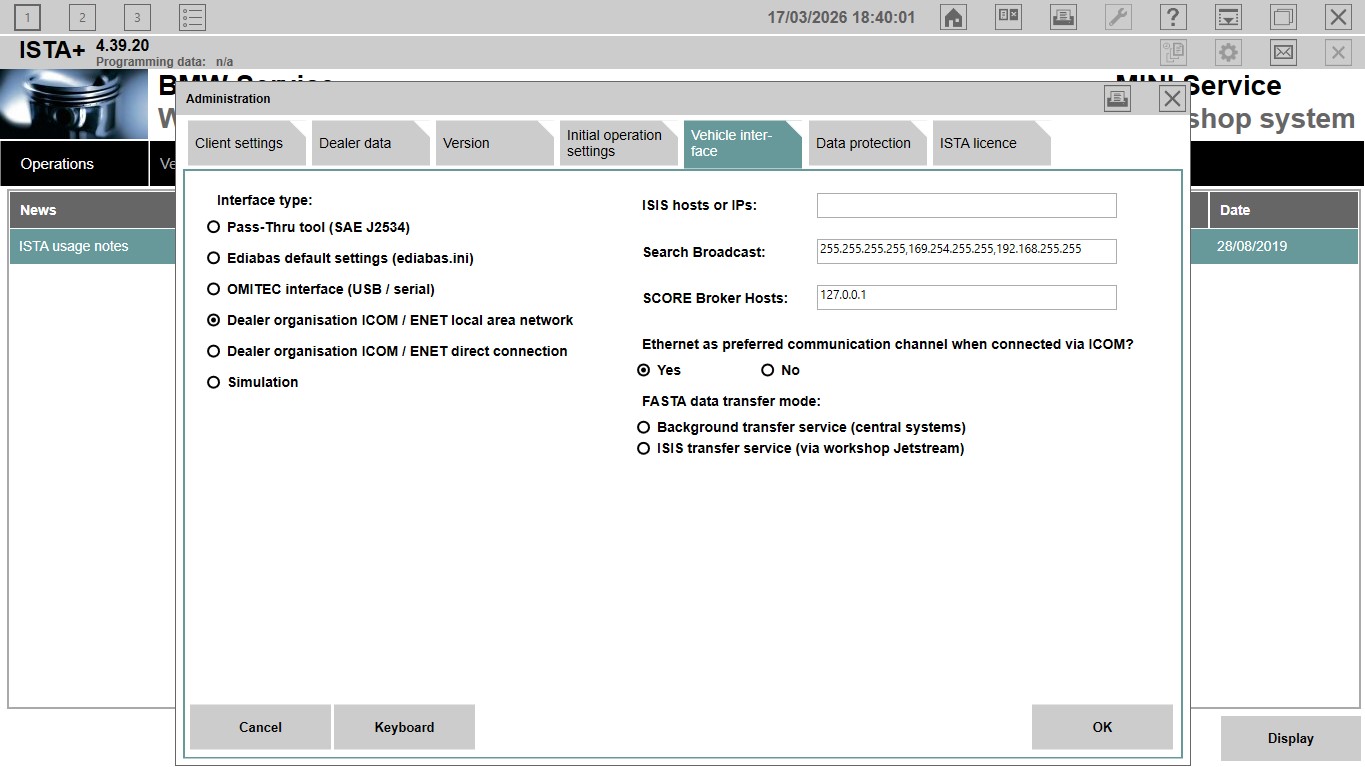

Trying to scan a code on my 2017 x5 35d, I have installed ista+ following bimmerdoc video and using enet cable. It seems like it will detect my vehicle but when i try to connect it asks me to put my VIN in manually. If I do it will fill some information in the background but will never really finish the process and then the car will hit the sleep timer and shut off. Been googling all day but not coming up with any solutions. Any help is appreciated.

What are the ENET connection settings within ISTA? 169.254.x.x indicates a link-local address, which means that the car/adapter tried and failed to get an address from a DHCP server.
If I had to guess, you'll likely have to manually assign an IP to the adapter/car or setup a DHCP server on the computer

I believe you are asking about these settings? I am new to ISTA and BMW in general.
