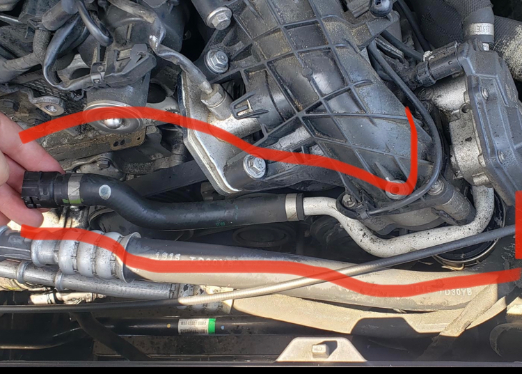

Any thoughts what to do with this line? Coming to the changeover valve so I'm not able just remove that EGR cooling circle?

Help needed
Not sure if you got your answer.. I was told to cut it where I marked it for you with yellow and plug it up. No issues..
I got my plug for it from Darkside.
