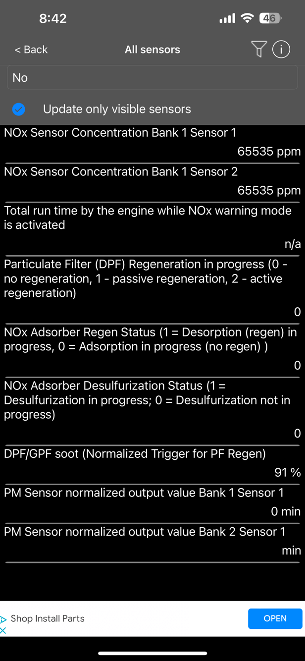

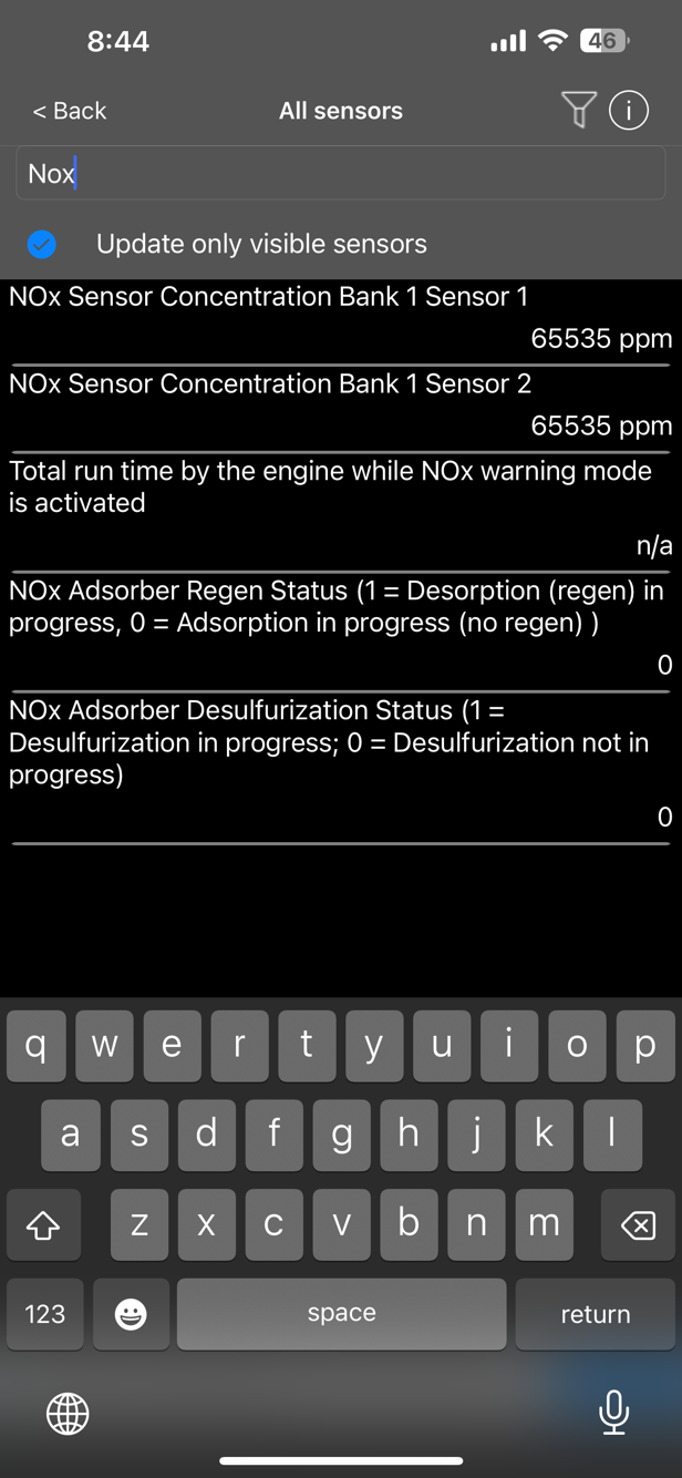

I just bought BMW X5 F15 3.0 diesel, 130k km mileage. I drove over 1k km already. When I decided to check the level of AdBlue I found that there is no AdBlue level menu item in Vehicle Info. I tried to connect ELM and found that NOx sensor shows 65535 ppm - it's maximum value.
Previous owner said that he hasn't removed that system and that once he got notification to add AdBlue. So, I am in doubt whether my BMW still has this system, or it was entirely removed before me.
How can I determine if that system still here and why I don't have AdBlue in vehicle info?
I will really appreciate if if if you can share any thoughts about that.

Finally I found that system works, level is missing in menu, but when it’s time to add - it start showing message that car will stop running in ~1600 km

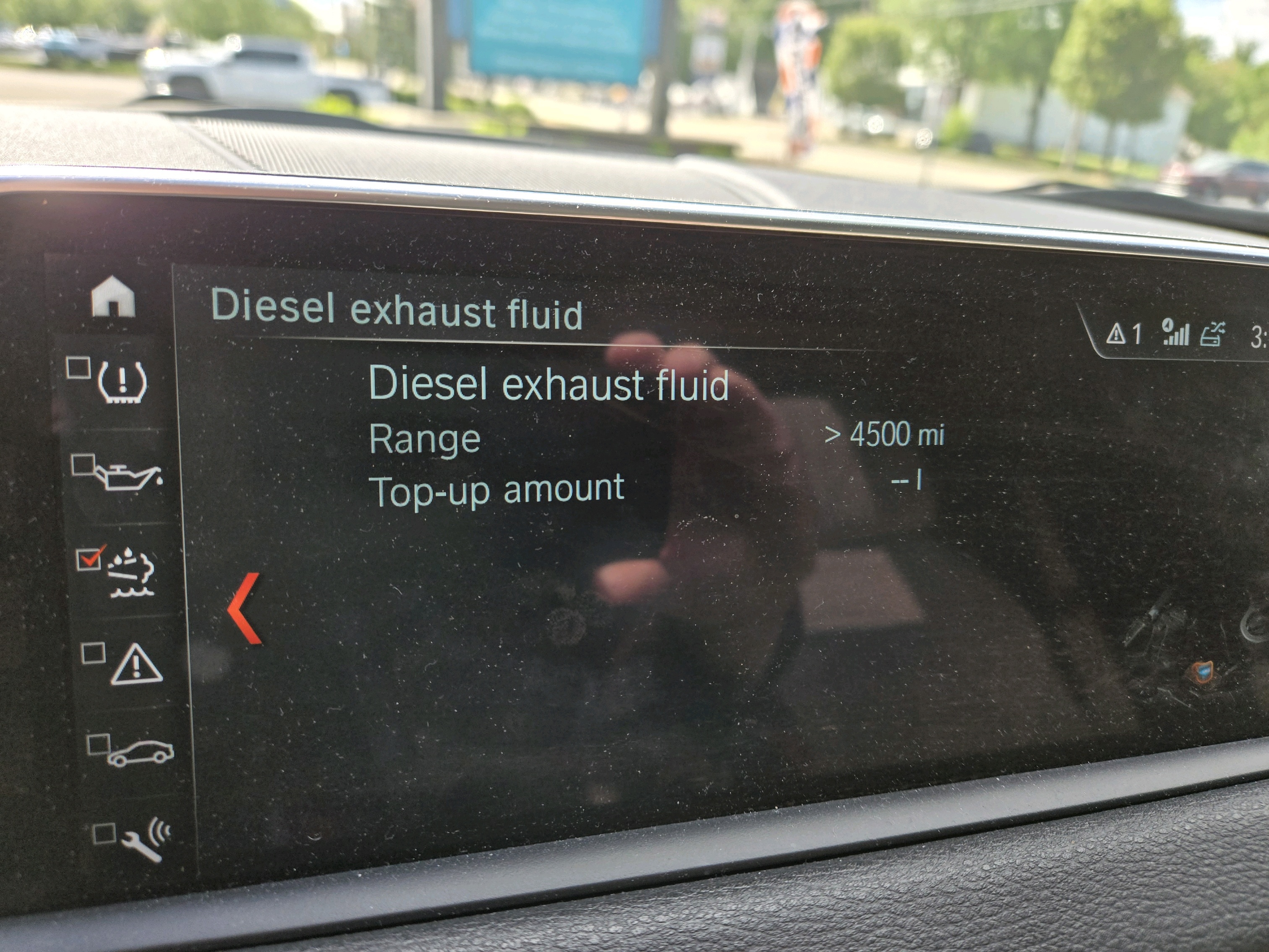

SCR_ANZEIGE enables the display
SCR_ANZEIGE_NEU is another option but does not seem to have any affect. Unsure if the actual level is being read, it gives a range but that's it.
