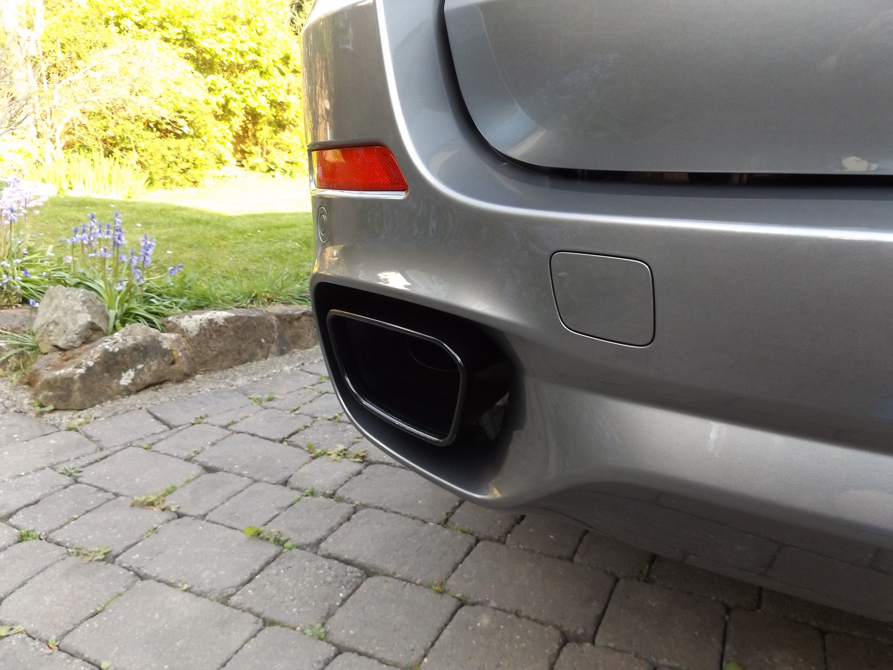

Mine are still perfect with no prep work/sanding done to the tips prior to installation. But only one month old at the moment.
Cheap and very easy to do.

Location: England
http://f15.bimmerpost.com/forums/att...1&d=1462484574

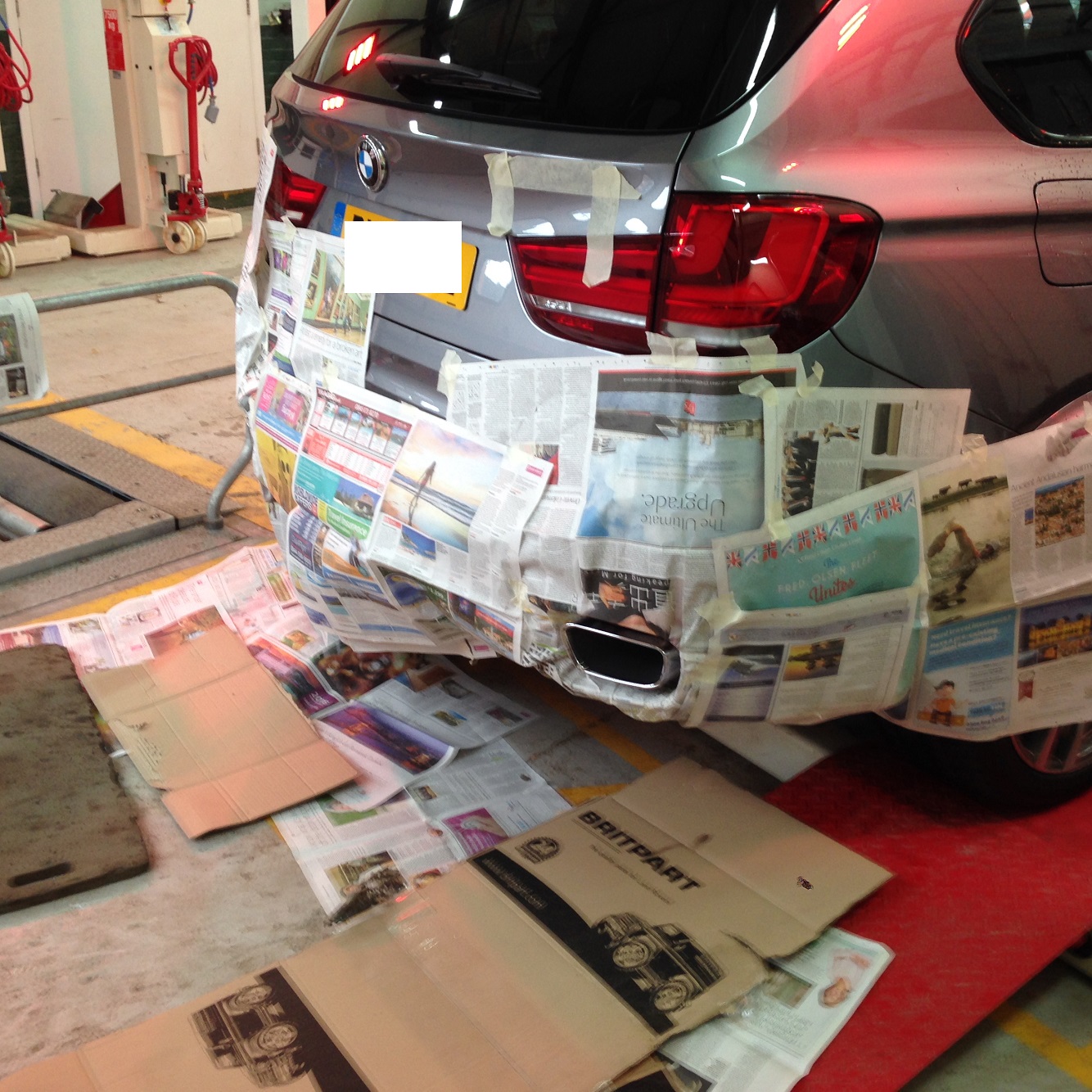

I did mine inside a garage, you need to make sure theres no wind also!
Very easy to do though, just take plenty of time when you newspaper the body up!
I went over the top with mine, but it was my 1st effort and wasn't sure how precise I was going to be!

      05-19-2016, 10:57 AM   #51
Originally Posted by Jdavuga View Post
http://f15.bimmerpost.com/forums/att...1&d=1462550584
How long did you wait for it to dry? How many coats did you spray?
Thanks!
      06-30-2018, 08:28 PM   #64
Originally Posted by momoney1102 View Post
How long did you wait for it to dry? How many coats you spray?
Thanks!
I left it overnight to to be sure that it is fully cured.
Coats wise, up to you. Minimum I did was 4 coats.
