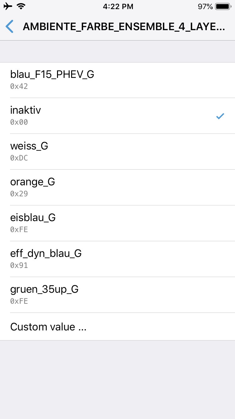

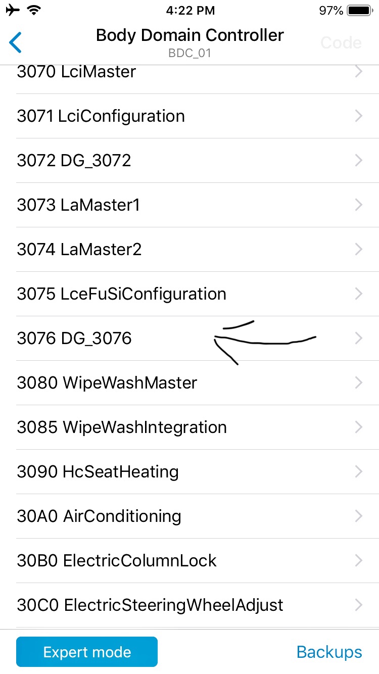

Go to BDC
Then 3076 DG_3076
Then AMBIENTE_FARBE_ENSEMBLE_4_LAYER_1_R
AMBIENTE_FARBE_ENSEMBLE_4_LAYER_1_G
AMBIENTE_FARBE_ENSEMBLE_4_LAYER_1_B
Then AMBIENTE_FARBE_ENSEMBLE_4_LAYER_2_R
AMBIENTE_FARBE_ENSEMBLE_4_LAYER_2_G
AMBIENTE_FARBE_ENSEMBLE_4_LAYER_2_B
Then AMBIENTE_FARBE_ENSEMBLE_4_LAYER_3_R
AMBIENTE_FARBE_ENSEMBLE_4_LAYER_3_G
AMBIENTE_FARBE_ENSEMBLE_4_LAYER_3_B
and pictures what you need to change to get nice blue and will appear in 4th colour option in idrive

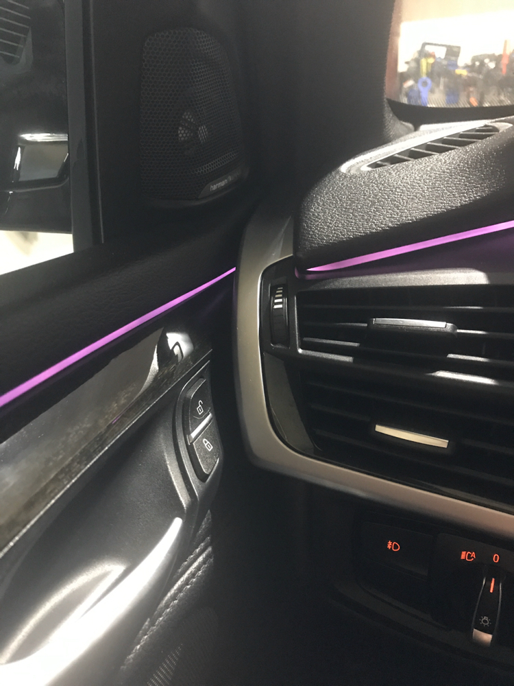

Just tried the method above on my 2015 X5 (with the newer software) last night and it worked great. Here are the settings I used to change my 4th color group into bright red (hellrot):
AMBIENTE_FARBE_ENSEMBLE_4_LAYER_1_R: orange_R (0xFE)
AMBIENTE_FARBE_ENSEMBLE_4_LAYER_1_G: inaktiv (0x00)
AMBIENTE_FARBE_ENSEMBLE_4_LAYER_1_B: inaktiv (0x00)
AMBIENTE_FARBE_ENSEMBLE_4_LAYER_2_R: orange_R (0xFE)
AMBIENTE_FARBE_ENSEMBLE_4_LAYER_2_G: inaktiv (0x00)
AMBIENTE_FARBE_ENSEMBLE_4_LAYER_2_B: inaktiv (0x00)
AMBIENTE_FARBE_ENSEMBLE_4_LAYER_3_R: orange_R (0xFE)
AMBIENTE_FARBE_ENSEMBLE_4_LAYER_3_G: inaktiv (0x00)
AMBIENTE_FARBE_ENSEMBLE_4_LAYER_3_B: inaktiv (0x00)
Don't let the "orange" confuse you - that's just setting the red channel to full, which is the same thing that the orange preset does. In fact, the first time I did it, I chose Custom Value and entered 0xFE, and it automatically selected orange_R for me since it was already an existing choice. By turning off the green and blue channels, you get full red.
Also worth noting that the color selection in the car's menu still shows the old name, in this case "Blue/White/White", but selecting it definitely lights the car up red.
My black interior now has a nice Darth Vader vibe to it at night.

1. Folder 3076.
2. top line 3076_3_3_255
3076_4_4_255
3076_5_5_255
3. middle line 3076_6_6_255
3076_7_7_255
3076_8_8_255
4.bottom line 3076_9_9_255
3076_10_10_255
3076_11_11_255
Color hex
Thank you!
So, if you have E-SYS with old launcher, where is no information in folder 3076, you can code embient light for all presetns in nbt by coding strings (change werte parametr in fuctionen):
1 color in nbt (string number 3-11, like in this example):
top line
3076_3_3_255 red color hex
3076_4_4_255 green color hex
3076_5_5_255 blue color hex
middle line
3076_6_6_255
3076_7_7_255
3076_8_8_255
bottom line
3076_9_9_255
3076_10_10_255
3076_11_11_255
2 color in nbt (sring number 24-32)
top line
3076_24_24_255 red color hex
3076_25_25_255 green color hex
3076_26_26_255 blue color hex
middle line
3076_27_27_255
3076_28_28_255
3076_29_29_255
bottom line
3076_30_30_255
3076_31_31_255
3076_32_32_255
3 color in nbt (sring number 45-53)
top line
3076_45_45_255 red color hex
3076_46_46_255 green color hex
3076_47_47_255 blue color hex
middle line
3076_48_48_255
3076_49_49_255
3076_50_50_255
bottom line
3076_51_51_255
3076_52_52_255
3076_53_53_255
4 color in nbt (sring number 66-74)
5 color in nbt (sring number 87-95)
6 color in nbt (sring number 108-116)
7 color in nbt (sring number 129-137)
8 color in nbt (sring number 150-158)
and so on
Thanks to this write up I was FINALLY able to code my 2015 with different ambient lighting!!
Finally!!!
When I pressed the code button and turned the car off and it was red ambient lighting, damn near fell out of the seat lol.
Funny thing is I've changed settings before but never knew exactly how many needed to be changed. This write up made it simple, and I was able to get rid of the ugly ass yellow colour I managed to create before lol

Yeah but honestly as soon as you click it, it changes and you know which colour it is. Personally I can deal with the names not changing for the better colour choices lol
