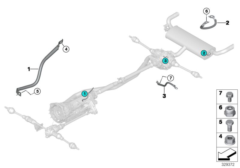

Have you checked all the ground straps? On previous gen getting a codes like this and no-start was common when the engine ground strap fried. On the F85 I don't think there is one by the front diff anymore and looks like they moved it back to the transmission area plus one by read diff and one on muffler. You can also add a ground cable to test the theory from any large bolt that goes to the body (front brace, struts, etc) to the engine and see if it makes a difference.
There are also multiple sub grounding locations to check, You can find their locations on BMW TIS. PM me if you need info on how to access if you dont have it it alraedy.
BimmerNewb79, I take it you've already thoroughly verified SophisticatedRedneck's suggestion, and found all indicated connections nice and tight, right?
I ran out of time yesterday (setting up ista) to get the car up on stands to check the ground straps under the car, but everything I have been able to lay hands on, on the top side has been fine.
