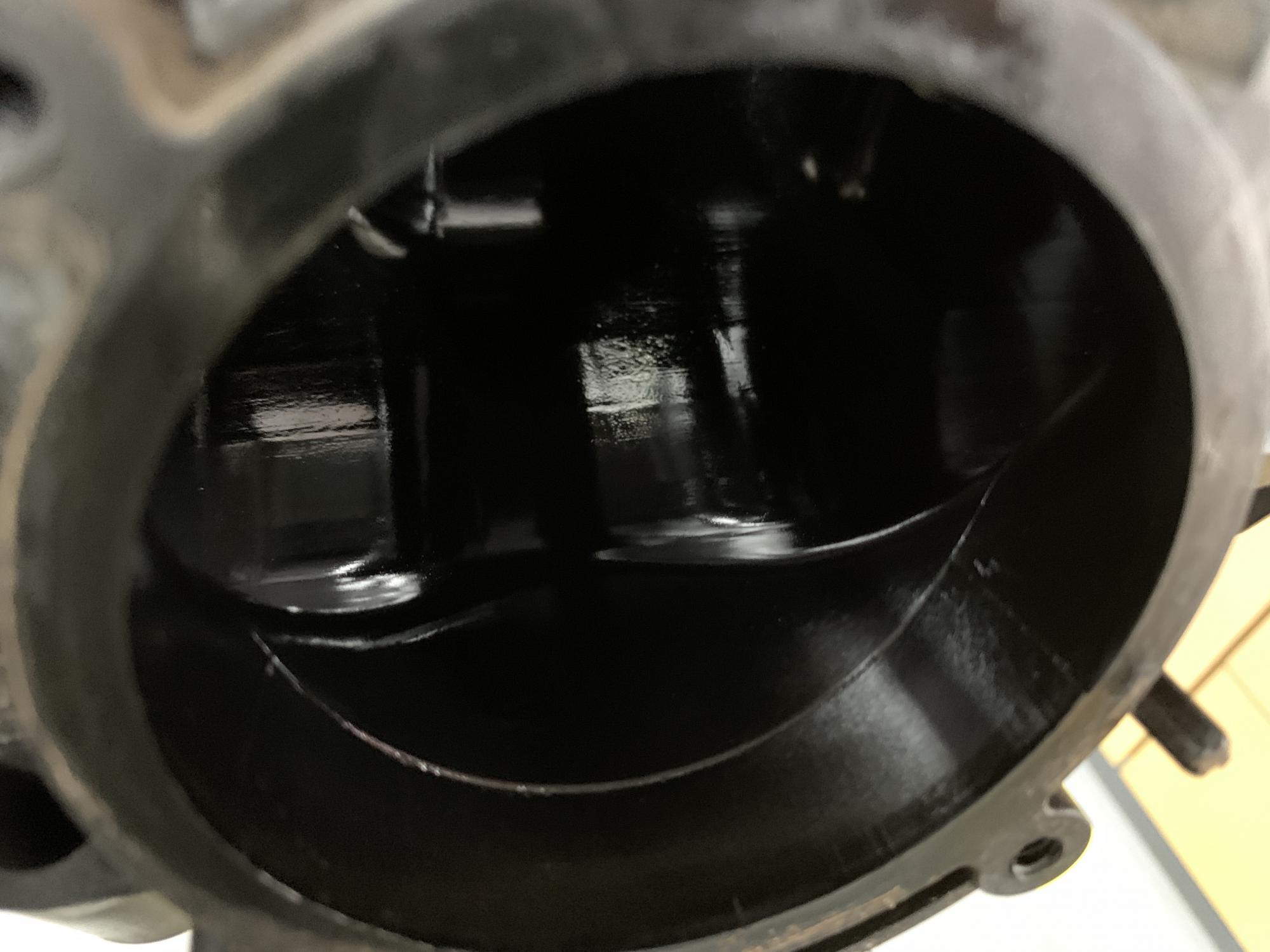

Lots of oil residue in the intake manifold, a good opportunity to clean.

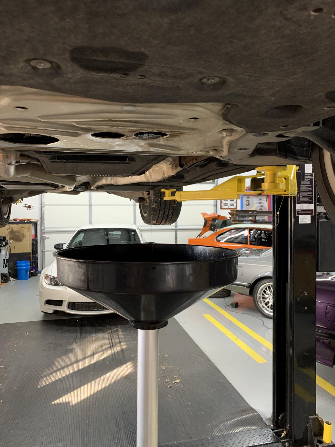

Took the opportunity to let the oil drain overnight for my change. Not normal to get that thorough of a drain.

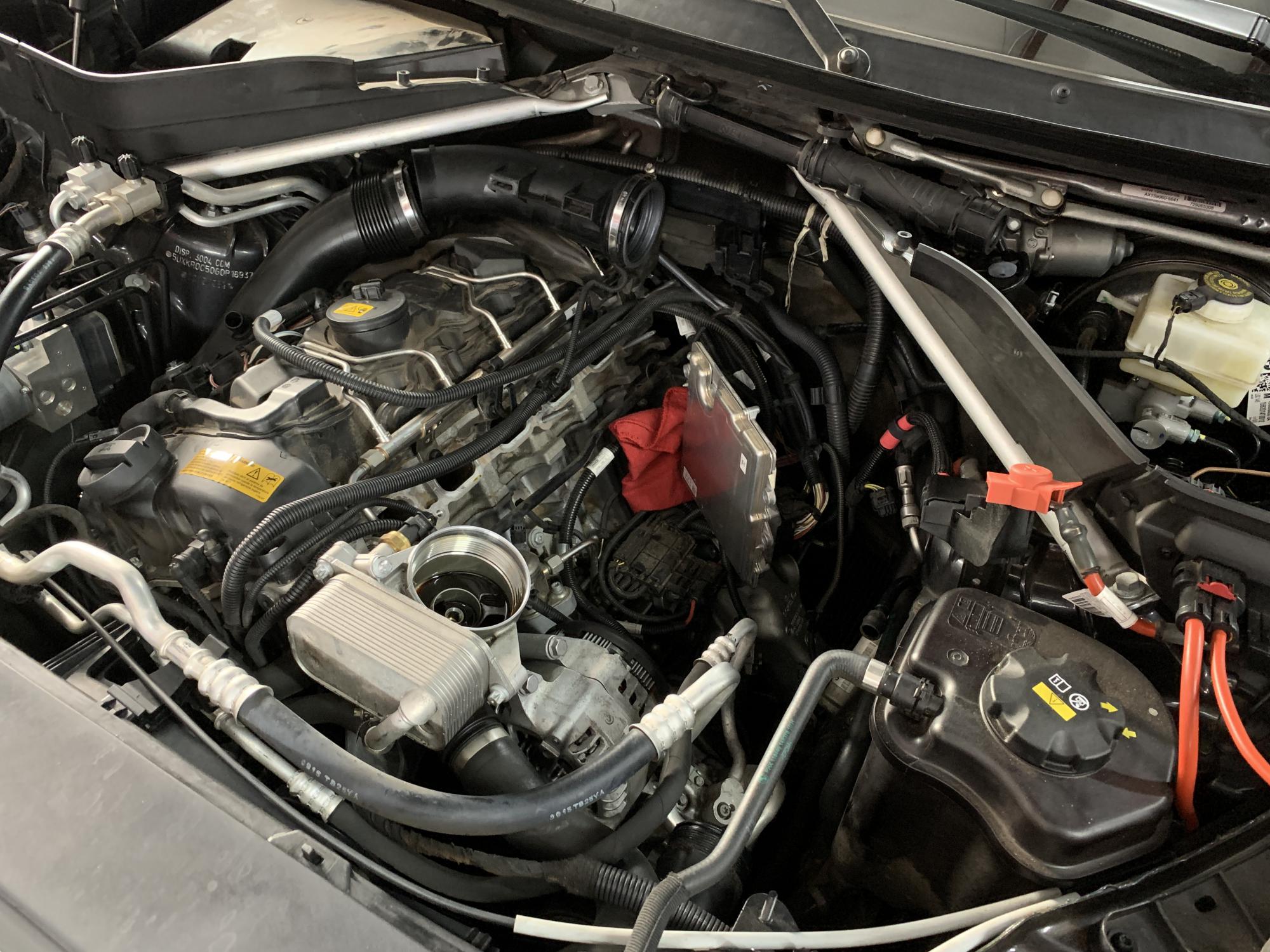

This is the point of leakage at the filter housing. You can see where a failed gasket will cause oil to run down the front of the engine. This pic also shows why it is difficult to detect visually with everything installed.

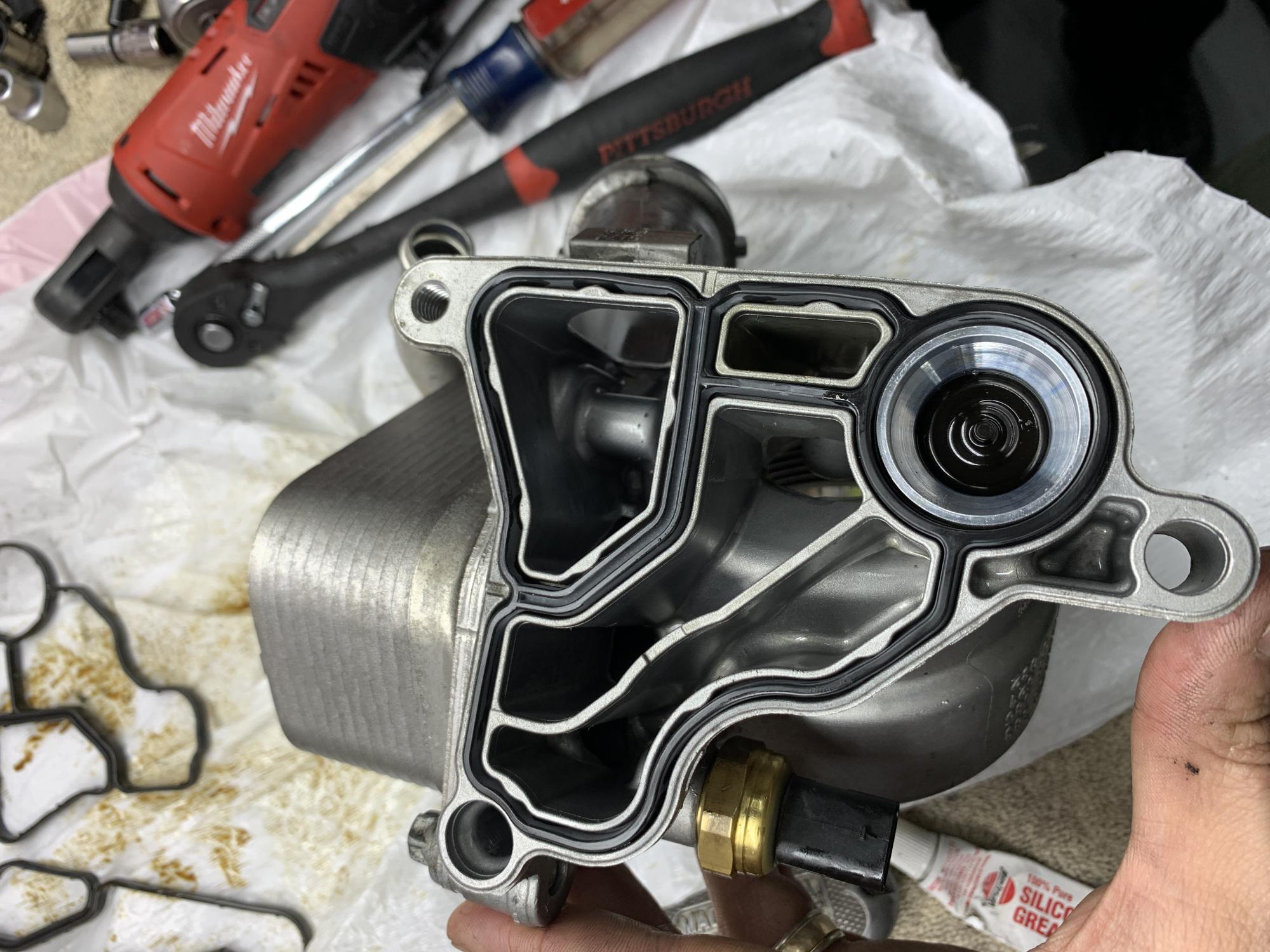

This gasket divides the chambers of the filter housing and is also a source of leakage. You’re crazy if you don’t also change this while it’s out.

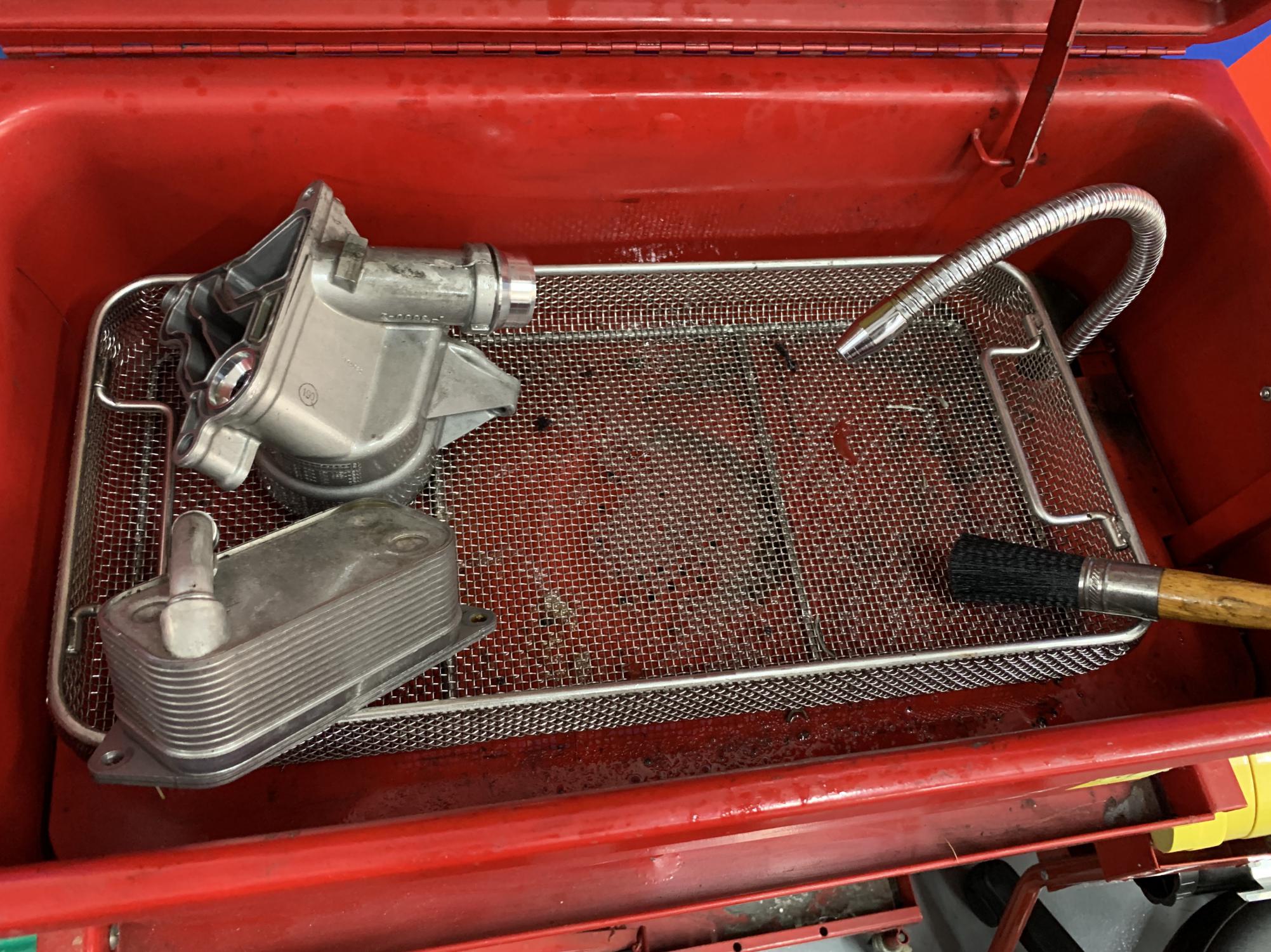

Both chambers in the parts cleaner. (Remove the switch if you’re going to do this)

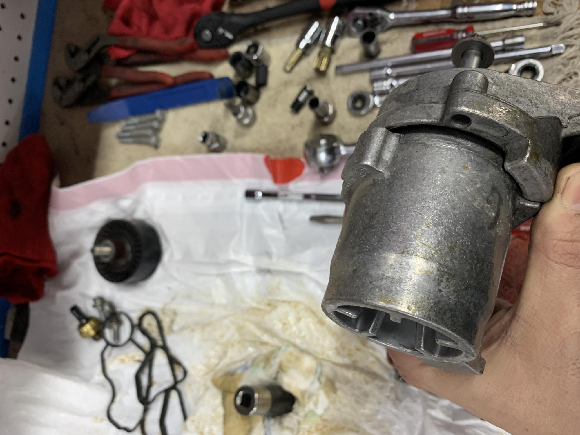

This is the drive belt tensioner; hard to see in the pic but a lot of oil had run inside the spring housing.

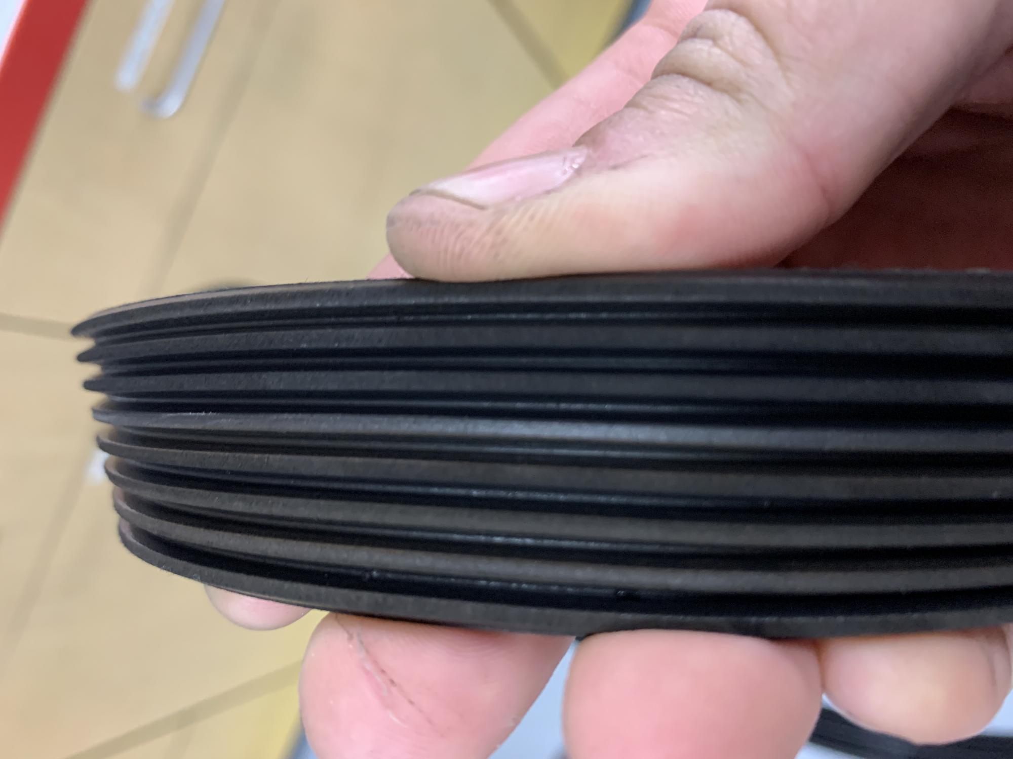

Old belt looked really good at 100k miles, but changed it anyway.
